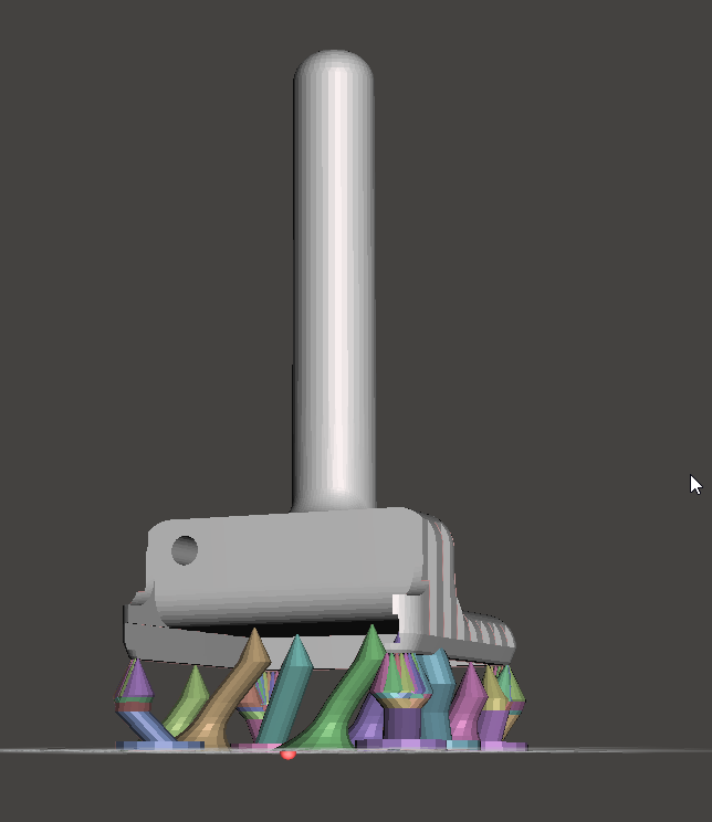

Elliot wrote:
I also made a mount for the UV sensor with measurement tabs on the sides to allow easier identification of where the sensor is being placed on the grid.  Again, if you guys are interested I'll post this handle in stl in a separate post.
I was planning to make a mount for my sensor as well, I'd love to see your stl information!

Re: band pass- Would that work, I had thought of that.  But if the sensor cuts off at 390 it still doesn't register above that value...correct?
Re: Stl I'll post shortly
Re:Brightness
So what I found is that with higher brightness settings in the viewsonic, even with high contrast, the bleed-out overcomes the contrast...black is not black anymore.  So high brightness affects other areas.  So what I'm trying to do is find the sweet-spot that allows reasonable curing times while having very good control over light transfer to other areas you don't want cured.  We have to assume that the light is being refracted as it enters through the glass and then the resin.  I'm starting to work with some lenses that allow better collimation of the beam without dispersion.  So if we get the filters on the viewsonic right, and have basically the highest tolerable UV band when black is black.  That's the sweet spot.  Then Start with brightness (lamp intensity) around 20-40% we should be closer to having a normalized projection.  Maybe I'm not understanding how the greyscale is being done...is this basically a contrast setting customized for different areas of the Ti chip?
Thanks!

UV sensor handle.  Can I upload the .STL to the attachments and submit to you guys that way?  (Sorry this method of forums is new to me)
