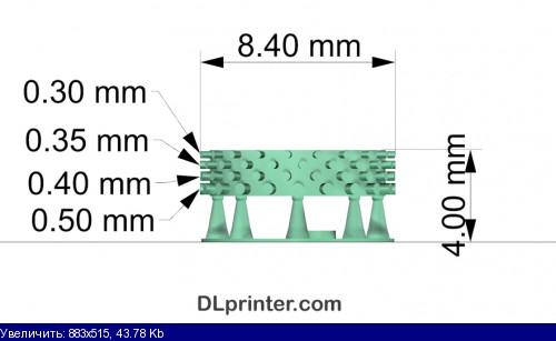

I make this special test model for check overexposure the small prongs in horizontal direction is most sensitive about overexposure ,
but maybe you're right
If I can have chance to have such a model I will check it , but any way it is already great add ons to nanodlp !
