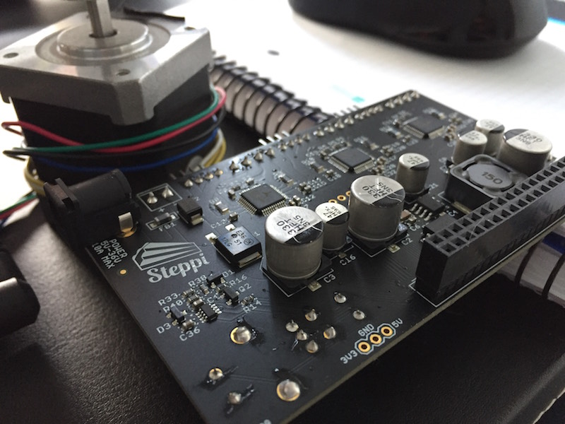

Hi,
This is my first post so hello everyone smile
In my free time after work, I've been developing a stepper motor shield that fits the Raspberry Pi and similar ARM computers like the Pine64. After several prototypes and coding I've finally finished a fully working piece of hardware that can be used to control up to 3 stepper motors using Python with smooth movements and a precision of 256 microsteps. It takes care of the step/dir signals, avoiding micro-cuts in the movements due to the overhead needed to directly control a stepper motor with the Raspberry Pi. It also prevents you from having to buy Arduino + Stepper driver shield + LCD screen & buttons. Takes care of giving power to the Raspberry Pi and you can control the power-up and shutdown process with the press of a button, it's an all-in-one solution to make a stand-alone DLP 3D printer or any other project that involves stepper motors with the Pi. It also has connections to power and control a couple of servos, and limit switch connections, although the latter is optional as I'm using Trinamic's drivers so theoretically they can detect if you reached a physical stop, but I'm still experimenting a bit more with that.
I made a Python API to control the steppers in an easy way. This is a simplified example:
driver_current = 1.1 # Electric current used to move the stepper motor in Amps
target_position = 7*200*256  # Target position in microsteps to make a 200 step motor do 7 full turns
velocity = 200*256 # Velocity in microsteps/second to make one turn per second.
setup(mot_X, driver_current) # setup the stepper driver
set_target_position(mot_X, target_position, velocity) # make the stepper move to the target position
I'm planning to launch a Kickstarter and release the source code soon, so I'm very interested in making NanoDLP work with my shield, but after some tests, the only thing I have managed to move are the servos, as they are directly connected to GPIOs.
What would be the better way to make nanoDLP communicate with my python API?
Any help would be appreciated,
Thank you!
Edit:
I add a couple of pictures of the board just in case anybody is interested:

I ended up creating a Python daemon that creates a virtual serial port, stays listening for gcode commands and responds with Z_move_comp when a movement is completed, and it works!
I didn't want to directly call python from syscalls, to avoid the overhead of opening and closing context on each call. I first tried with a named pipe (fifo) and echoing to it from syscalls, but it had the drawback of not being able to wait and respond with a "Z_move_comp", so I discarded it. I'm also considering using the [[Net ]] keyword but since I didn't notice any serious delay with the serial port and probably the serial is more friendly with the way people uses nanoDLP I think it's probably better to use the virtual serial port. Do you see any drawbacks on using the serial port instead of [[Net ]]?
